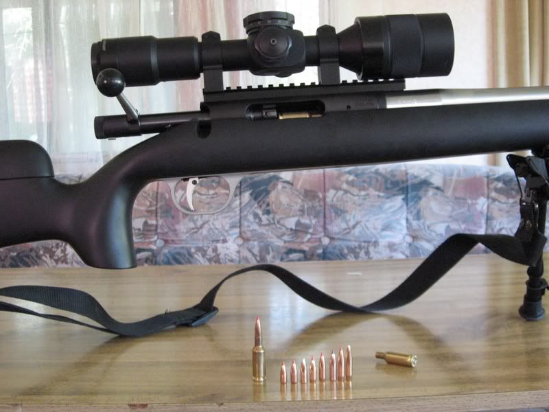

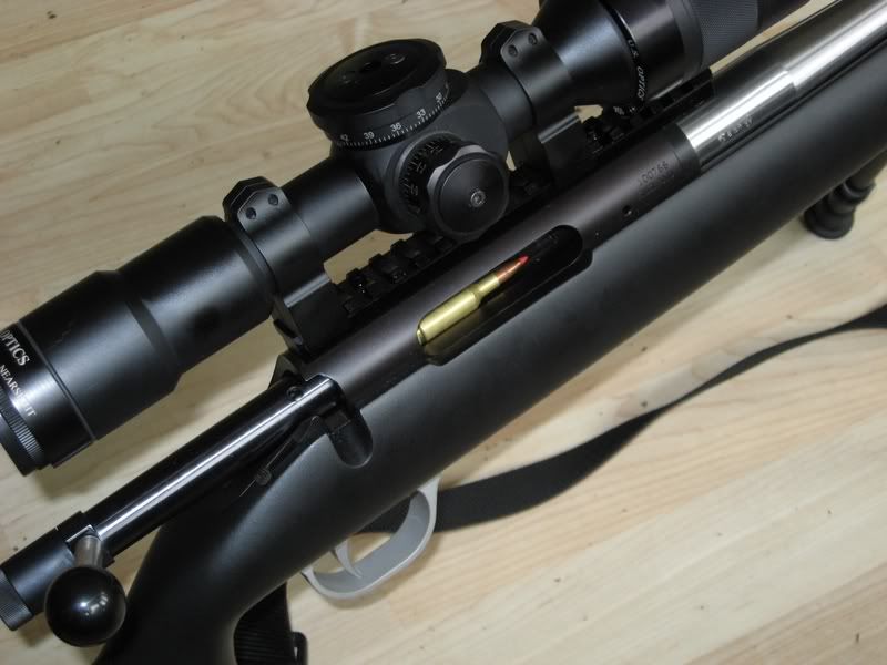

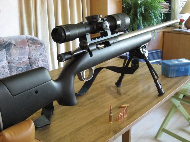

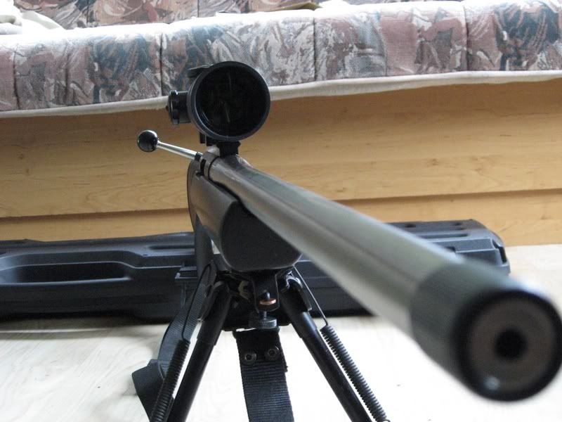

my new rifle
this is my new rifle
an rpa intercepter in 6BR
27 inch border barrel 1 in 8 twist
robertson composite stock
rpa action
20 moa piccatiney rail
us optics st 10 scope
warne ring
hope u like it
yea its more of an f class rifle realy with the 1 in 8 twist for the 105 grainers which i will shoot at my range but iv had the rifle 2 1/2 weeks now and shot 11 foxs and a roe buck already so its proving a good varmint rifle as well.
the 75 gr v maxs seem to shoot real well and make nice holes in the foxs im getting a fair bit of pressure though from mild loads which seems to be due to neck tension.
i bought a redding neck die set,non bushing) and i measured a sized case at .265 to .266 which is about 3 to four thou to tight so the redding competition bushing dies are on the way with .268 and .269 bushings
hope this helps
