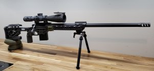

My new PRS build
Just put my new PRS gun together. This is my second one. I learned alot with my first setup. I am very happy with this setup.
-Zues terminus action with QC barrel setup
-6cm prefit Bartlein Heavy Varmint 400MODBB barrel for matches
-6.5cm prefit Benchmark Heavy Palma barrel for training
- Triggertech diamond trigger
- MPA BA comp chassis with full weight kit
- ZCO 5-27 scope

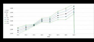

Impressive.
Good to see someone who chrons all his shots during load development. I was impressed with that low 5 FPS ES at 41.8 grains.
Q: What software are you using
for this load analysis? Who created that spreadsheet-style data tracker. (It would be nice to add group size value for each load.)
PS: I thought I recognized that range. Then I saw "Pala" in the location field. Great place to shoot. Been there, done that.

Using the 65 guys chart
That's a solid rig, what's the weight?
This fat girl weighs in at 24#s on the dot empty. A little heavier than I was hoping for but it's balanced exactly where I want it. I may shave weight on both ends to drop it a little lower but going to run it like this for the next match
Awesome rifle. What program are you using for data management? How do you like that ZCO?
The 65 guys program. See above for the link. I love the ZCO. I made the mistake of getting behind one at a match. After that I had to get one. Now I want to replace all my glass with them, that is if I ever win the lottery
I got a comp contour on the way for my MPA so I just wanted to make sure it was still good.
I am on running the rear monopod weight and the enhanced bagrider the light version.
My 6cm is a 26" heavy varmint. I have the same rear weight configuration you are going to do. Monopod weight and light enhanced bag rider.
I also have 6 gray ops external weights and the MPA internal weight kit out front.
If I decide to lighten it up I will most likely pull the monopod weight and as many external weights as it takes to balance it correctly
I didn't opt for the internal weights or external just yet. I want to use the weights to balance the rifle. I always felt 18 to 19ish pounds was good when it balance out
