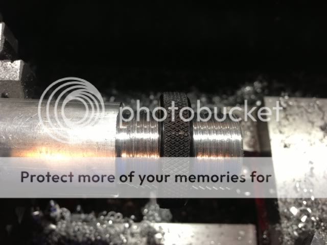

My new brass turning setup.
Actually, I bought it primarily to turn brass.
I've only had it for about a week, but I already put a quick change tool post on it, it's a must! I ordered the mini-lathe tooling package from littlemachineshop.com, it's a great investment.
Eventually I will buy a full size lathe, but in the meantime I will use this one to learn on. It's not the best machine in the world, but for the money it's a nice toy! ;D
I haven't had to build anything that requires precision yet. Today I was practicing threading and I cut a 7/8" x 14 thread like what's used on reloading dies and I was happy with the results.

Yes, but I will save that for when I get a bigger lathe.
