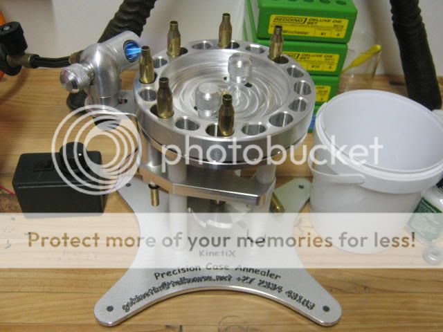

My new annealing machine
I just finished this machine and it works like a charm.
Check out this link to a video of it doing some .243 brass.

Looks great.. Are you planning on making them with dual torches?
thanks
Hi JP,
Dual torches are good on other some other models to distribute the heat around the neck or to get longer exposure time on the constant motion models. On this model the case turns in the flame so i do not see a real need for a secondary torch. However, if you want two or more torches i would be more than happy to add brackets for them.

Terry,
I have tested down to .22 hornet, but anything that sticks out above the plate (21mm or 7/8") should work fine. If you have a specific case in mind that does not fit, i can just make up a special wheel for you.
Pieter
Thanks for the quick reply baboonstalker. I shoot a 6 Dasher, 6.5-284 Shehane and a 300 Win. mag. will the one plate take care of all three are will need to get different plates?
Terry Pohl ???

If the cam advances the wheel 2 holes, why the extra holes?
If there was a way to load more in the queue (a hopper?) it would be helpful.

Itchy,
The wheel can be advanced to the other holes if you want to do smaller cases. Slacken the two thumbscrews on top of the carousel and advance the wheel so the other slots line up. Look at the pic, you will see how it works.
