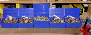

In addition to the Hornady cases I bought as cartridges that I pulled apart, I found what turned out to be 174 Lapua .220 Russian cases that had been resized into 6PPC cases and that I then resized into 6ARC cases.. As discussed above, that required necking up with a .264-caliber neck-expansion button and then resizing with a 6ARC FL resizer very carefully to leave a bump at the base of the neck to locate the case in the chamber...or in my case, a Wilson Cartridge Case Gage since I don't yet have a rifle.. Those are in the middle Lapua box in this pic.
Then I bought four boxes of new .220Russian cases from Bruno's.. These cases are also available online at BlueCollarReloading.com...
These will be upnecked to .257 using a PMA stainless-steel mandrel**...
...and sort-of-lots of case lube on the inside of the necks.. Then they'll be resized in a 6ARC die while creating a bump in the neck for fireforming purposes.. I've read of several reloadists' use of some material other than a bullet to fireform the .220 cases to 6PPC, but that all sounded too messy for me, and I've got LOTS and LOTS of 6mm GMX80 bullets to use, and a barrel to break-in, so that's what I'll do...if I only had a rifle***.
But we've got affordable cases now, HUH!?!?!?!?
