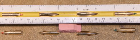

Got more Sierra 6mm TMK95s from Brunos (and have more coming from somewhere) and also 90- and 95g. Bergers.. Left to right and with OALs, these are the 80g. Hornady GMX factory-second (1.1106"), Berger 90g. Boat Tail Target #24425 (1.050"), Berger 95g. VLD target #24427 (1.126"), and Sierra 95g. Tipped MatchKing #7295 (1.187")..

Received a bunch of new-to-me 6mm Hornady GMX bullets​
They're more Midway factory-seconds. The GMXs are the all-copper-alloy, tipped hunting bullets, and the new one is the 90g. on the right.. They cost about twice the 80g.'s 27-cent price.
The 90 has a significantly higher ballistic coefficient of 0.422 v. the 80's 0.300.. Loaded three trios with them; I now have 20 trios to shoot next time at the range.. That's way too many to shoot and chrono during one of Ben Avery's 1-1/2-hour sessions, so I'll have to book two consecutive ones (for $15 total) or go to our east-Valley Rio Salado Sportman's Club...

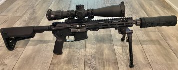

I’ve been shooting my 6mm ARC 10.5” at 800y and 18” at 1000yds with great success, both in AR15 platform rifles, with 108 ELD-Ms.
After I get mine running, maybe I'll try something like that.. As far as I can see on the Ben Avery Shooting Facility site, they accommodate public shooting at paper target at 5 - 300 yards (on two different ranges) and rifle-steel targets from 150-300 yards.
What scope do you use at 1000 yards? I have a Vortex Crossfire II 3-9X50 that works well on my '15s and also a Nightforce 12-42X56 on my (unused) benchrest rifle, but the latter is about as long as what I think my incoming '15 will be. (I exagerate, of course.)
ZCO 420 and ZCO 527, primarily, depending on the rifle. I've got a 527 on my 10.5" SBR right now, which is hilarious, but I am waiting on a backordered 420 to replace it with (much shorter).

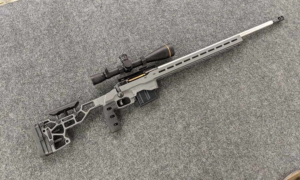

Meanwhile I'm moving from my 6Creed Savage 110 Tactical Desert...
...to the Savage 110 Elite Precision rifle in 6Creed.
Should be here Monday.. This was a easy decision for me since I have ALL supplies and tools I need for the caliber.. Already have the break-in loads planned to combine with my initial load-pressure testing.. Long bullets included in this initial series are the RDF105, MK110, and Berger LRH109, plus the TMK95s.
