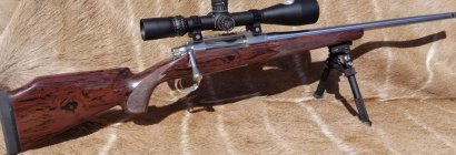

The bolt handle and fluted bolt look sharp on that Tikka!
