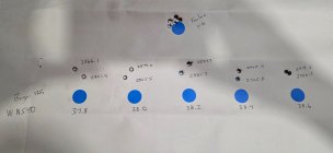

Just received the new replacement 131 gr. Sierra MK by UPS. Measured 10 random bullets from base to ogive and found .003 variance between the 10. Much better than the previous batch but will still need to sort to get best results. Re-testing seat depth when weather clears up. Lots of rain today and possibly tomorrow as well.
O K, not real sure this bullet will shoot with the Bergers but this new lot is definitely an improvement over the original ones we had. Seat depth went well and this bullet is liking .013 OTL as those original ones had shown us when I stopped testing and M V, E S, & S Ds are more consistent than the others ones as well.

Got mine back on the bench today and shot a couple groups. One to finally verify the new lot of Sierra 131 gr. replacement bullets and one just to see how my 135 gr. Bergers would act on a cooler day than when I worked up the load in the heat.
Was a tad slower @ .231 5-SHOT GP. 2933 FPS 13 E S 5 S D but still held just under 1/4 inch @ 100 yds. Had about half a bullet hole of vertical but I feel the tuner would probably get that out. I may go back and re-test a small increase in powder to 38.6 gr. just to see how it looks since my barrel now has more rounds on it. My M V was at 2998 FPS when I checked it previously in the powder run up but the tune looked better at 38.2 & 38.4 gr.
The Sierras were still lagging in group size behind the Bergers @ .356 5-SHOT GP. 2954 FPS 18 E S 6 S D with the same powder charge as the load I worked up. Again still need to check the tuner on both loads.
