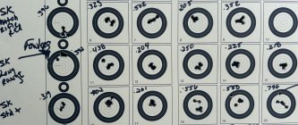

Well I finally got out this morning to do some ammo & setup testing with my new MTR Rebuild that I finished. Some of you may remember my past threads and probably wondered why not show groups or targets shot. Well I’m out in the country and we always have wind so it’s not always easy to shoot for consistency/groups but I do try.
Something else you’ll notice is I was able to get a new front rest from a person over on RFC. Real nice guy and I did some cleanup on it and added a calibrated level and fixed a cracked screw cap.
This morning was not ideal but favorable so I setup to do some testing with my new front rest and MTR.
Many of you may not think this is all that great but I’m very pleased with the results. I did test 5 different ammo’s in this setup and hands down it really liked SK Long Range! So in the end I just purchased 2 bricks from Whiddens.
Above is the setup from behind looking North. My mobile target is just to the left of my burm set at 50yds.
Weather conditions below
I started out shooting just a little bit of Norma Tac 22 to warm the barrel then just for fun gave some Magtech ago for groups. All shooting was done at 30x and moving from left to right and moving from the bottom going up with the 1st target considered FOWLERS. One could even argue that the 1st 2 targets should be considered but thats for you to decide.
In the end the best groups hands down are the SK Long Range with Standard + & Match Rifle as a close 2nd. (As a side note the last target on the STD + I blew a shot which gave me the .796 group size. Without that I’m in the .450-.500 range) Something that I have notice is the horizontal stringing of the Lapua and even other groups show that. Not sure why that is but I may tighten up the sides of my bag rest and see if that helps. All in all I’m really pleased as I’ve wanted to be able to shoot consistent groups at .300 and under and as of right now I think with the best 2-3 above I should be able to do that.
Also this barrel only has about 300-350 rounds through it so I’d think this should gradually get better as I shoot it.
