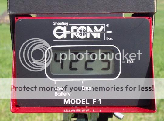

The bottom of the forearm on my Master Sporter is set up with I think what is called a European type accessory rail. For the most part, the bottom is pretty wide and flat, except for the recess for accessories to slip into the rail. I used Varget with the 40 gr. Nosler BT and during my tests I had three casings loaded with 39.5 gr. of Varget behind that bullet. After the first shot over the chronograph I decided to pull the bullets on the other two casings!!!! Here's a photo of the readout on the chronograph.

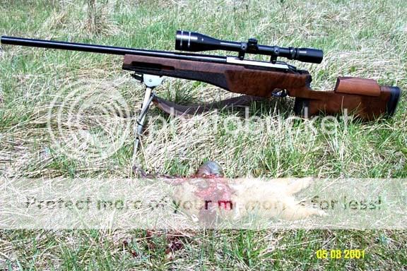

The load I settled on was 38.4 gr. of Varget and it has been a super-accurate load for me. Here's a photo of the first live critter I shot at. I was using a 40 gr. Nosler BT bullet that left the barrel slightly under 3,950 fps. The shot was taken from 165 lasered yards. DRT
I hope you can find one of these Tikka Master Sporters. Very accurate right out of the box!
