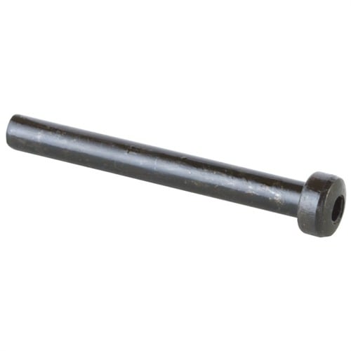

I have made many action screws from these blanks. They used to come with a lot more than 20.
You can insert them from the back side of a 5C Collet most of the time, Depending on Collet mfg.
Thanks. Unfortunately I'm not setup to make my own screws. You have me thinking though I'll talk with a buddy of mine in MA if I strikeout.
