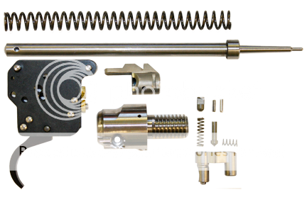

You can add one of these, they are drop in, no machining. I just bought one. Adam
