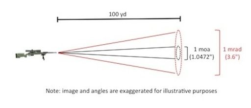

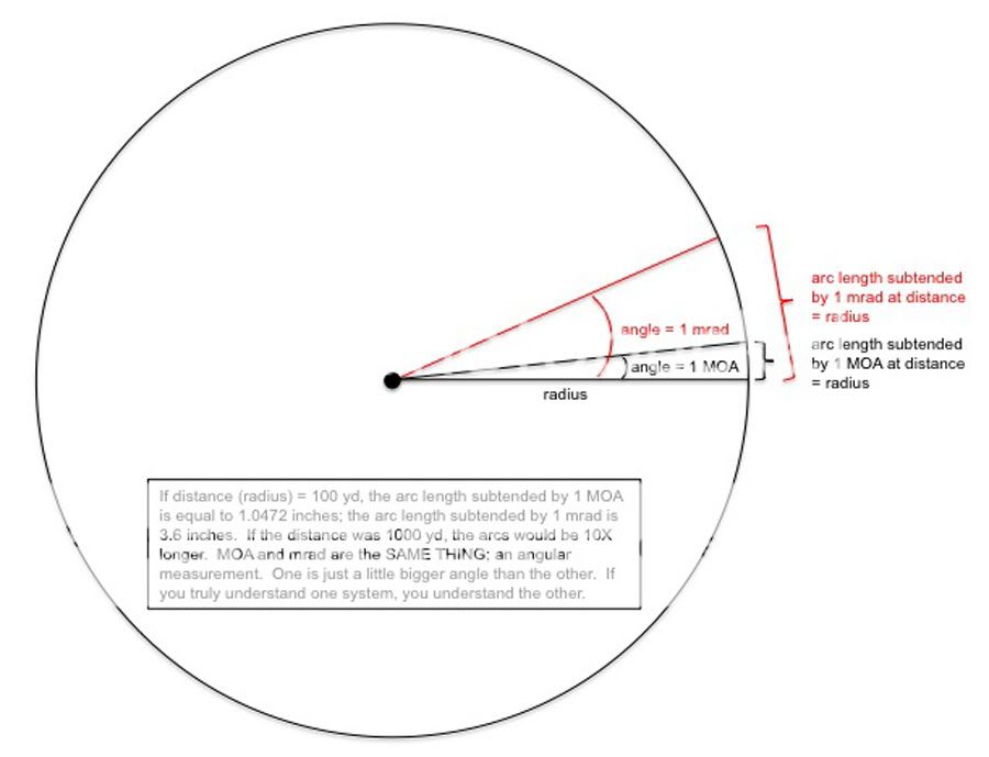

Seth - these pictures illustrating MOA and mils may help. FWIW - an angle is an angle, it doesn't change no matter how far out the lines (rays) go. The only thing that changes is how far apart a point on the rays will be as the distance increases (i.e. what we're "measuring at the target). This stuff really only becomes complicated when you start trying to convert "clicks" to some linear measurement on a target face at some specific distance. Leaving angular dispersion as an angle, rather than a linear measurement is a good place to start to minimize confusion, until you have a better picture in your mind of what's really going on.
