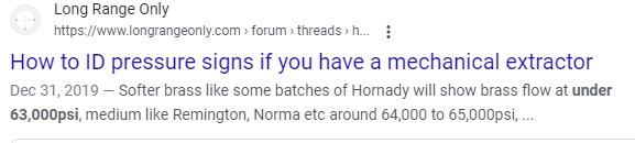

I was at the local range one day and there was a feller down a few benches, shooting an AR. Just blasting away and having a good time. He cleaned up his stuff and went on his way. After my sons and I were done, we went over and notices a pile of brass the man had left behind. All 308 Win, factory Hornady stuff. I say factory because the primer pockets were still crimped so I'm 99% certain they were not reloaded but let me tell you! I've never seen such over-pressure signs in my life! Brass flow into the ejector more than i've ever seen and brass smears on the case head. A few even had pin holes in the edges of the primers with a small amount of black gas that escaped. These brass were TRASHED! I only wonder how HOT these were and how long that poor gun would last by shooting them..
Dan
Who knows who built that gun though. Low quality bolt with a large firing pin hole? Over gassed? Lots of unknown information to just assume it's over pressure.
Agreed. Not going to argue that point but the gun was spitting out brass at about 2-3 oclock consistent pattern and the rims were not ripped off, nor did they show any signs of a timing issue or over gas like you'd expect. Just blown out primers ( on the sides not center around the firing pin) and ejector flow so bad that I'm surprised that there were no failure to eject, that I saw. The ejector flow was 60 thou or more : O. I've tempted fate before and pushed some reloads into pressure (doing my own testing) and this was WAY beyond that. The bunter stamping was even ruined on some. For a factory round to exibit those signs, I'm not sure a bolt could be the blame.
