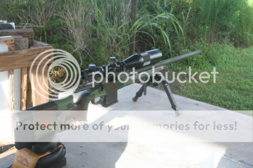

I shoot FTR with it both at 600 and 1000yds. Throated for 90vlds, but shoots 80vlds well also.
Drew
Drew, Thanks very much for the reply. Please provide more info on the powder choice of these bullets. Any other load info would be helpful. I am not asking for the exact load since I understand that is gun specific but any details would be helpful. Also, have you tried other bullets?
Drew, I also notice that the scope aft (ocular) lens is about even with the trigger with the scope on an extended rail. This is no small detail that I do not hear folks talk about but is important to getting a good position. How did you arrive at this configuration?
30" Bartlein Barrel
1:6.5 Twist Barrel
80 SMK
23.2 grains of IMR 8208.
2850 fps.
I can shoot the Berger 90's, but my rifle is throated for the 80's, so to shoot the 90's I have to reduce the powder load due to setting the bullet so low in the case. Accurate, but I lose about 100 fps.
To be honest the 90s have been a battle. This is my experience, but it comes from nearly 1000 of them in 2 barrels. Have tried two powders personally - Varget and IMR8208XBR with very good (but not perfect) results. Others have tried H4895 with good success but I have not. I'm back to varget and will shoot a match this weekend with a new recipe. The 80s shoot so well with varget, I've only tried it. With the 90vlds, I can shoot mid 190s at 600 pretty consistently, but have been trying everything to get higher scores (but the shooter is also to blame). There is a very good write up on getting the 90vld started. Everyone trying 90vld in 223 should read it. If you google "mighty mouse gun on steroids 223 90 vld" it will be the first hit. This is where I started.
As for the optic position, my personal preference is to mount the scope in rings loosely and then position myself behind the rifle until I am comfortable. I then adjust my stock (if equipped) to get close to the proper eye relief. The Eliseo is great for this as it is almost infinitely adjustable. I heard a fellow shooter remark that if the Eliseo stock does not fit you, you just don't have enough allen wrenches. So true. Once close, I then move the scope fore-and-aft in the rings until I get optimum sight. Once I think I am finished, I get up, then get on the rifle and assume my shooting position - WITH MY EYES CLOSED. Once set, I open my eyes and if the reticle is "right there" every time I do it, I do what needs to be done to get the reticle level at that position and tighten the screws. If not, I continue until it is "right there" every time I get behind the rifle. This is a long answer to say that's where it ended up for me on this particular rifle.
Drew
