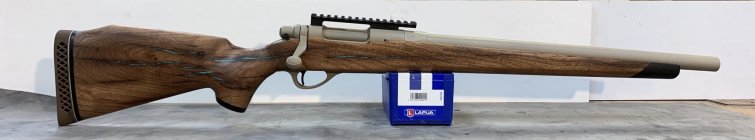

View attachment 1490500View attachment 1490501I got an action with a bolt. The bottom metal and trigger were available, tho the trigger’s bolt release part wouldn’t function with the bottom metal. I had to cobble a 700 internal magazine to work in it. The hardest part to find was the bolt release and spring. A very kind gentleman in Texas finally came to my rescue. I made a redneck bolt release button out of some brass rod. It came together in the end but it was a process.
That is a slick little rifle. What caliber? My guns are factory, but I bought them back when they could be had in the $350 - $400 range. I used to hang out at Kenny Jarrett's and he used the 600 to make "truck" guns. Sadly I didn't purchase one. But I had a mutual friend who had Kenny barrel and pillar bed his wife's 600/6mm with a mid weight barrel using the factory stock. I think back then he used a Hart barrel. But it doesn't look like that one you built! If I can get to work on time I plan to use my factory 600 to play "wack a doe".

That gun is a 223 in a Mesquite stock. I made for a young girl here in Texas, as her first rifle.
