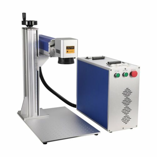

Sounds like a 20-30 watt fiber laser?
Just poking fun at you. I probably should have gotten something 10 years ago but they were pretty pricey then. I still might if the right contract comes along.
We have several local gunsmiths that drop by to have us laser engrave their barrels. Crud, even I have stopped marking my LRBR barrels with a permanent marker and now use the laser......
