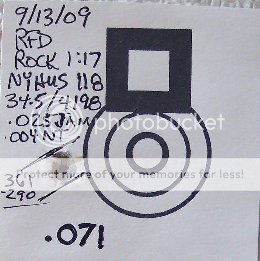

Mikem: Bullets make different sizes in target paper due to the flexibility of the paper. You're correct that different types of target paper will produce different size holes with the same bullet diameter.....that's why you use the diameter of a single hole in the target paper being used as the 'standard' when figuring group size. Here's a target shot with a .25...as you can see by the figures, a single bullet hole in this instance made a .240 hole in the paper, so that's what I used to figure group size:
In IBS/NBRSA sanctioned BR events, a measuring device is attached to a caliper and scribed outside circles that coorespond to different bullet diameters are lined up on the outside of the holes to get the group measurement.
Charlie and Cheryl Hood make the slick little Kwik Estimator that uses tapered lines to achieve the same result. http://www.benchrest.com/hoodpress/kwik_estimator.html
Good shootin'. :) -Al
