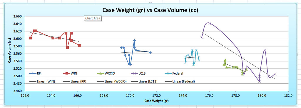

Ron Blain's chart is interesting, but they say a picture is worth a thousand words. So I took his data and turned some of it into a chart.
Case Weight vs Case Volume
It shows in a pictorial way case weight vs case volume for each of the five different brands of brass. Several things are easier to see in chart form than in tabular form. For example, the more a particular line is spread out from left to right, the greater the variation in case weight. The greater height of a particular line, the greater variation in case volume.
If variations in case volume are important to precision, then the WCC 10 or Federal would seem to be the better choices.
I put a trend line on each brass brand. The flatter (more horizontal) the line, the less the case volume varies with weight. A steep trend line, like that shown for the LC 13 brass means the volume varies a great deal with weight. One might argue that sorting Federal brass by weight is a waste of time while sorting LC 13 brass by weight is mandatory, assuming case volume means something.
Notice that three of the brands show less volume with increasing weight. Two brands are just the opposite; i.e. the heavier the case the more water it holds. I'm not going to guess why mainly because it doesn't make sense to me at first glance.
The chart also shows that, generally speaking, the brands which are heavier hold less water. That makes sense, to me at least, because it seems that cases which have the same external dimensions should have less volume if they're heavier as long as they're made from the same material. Of course, the way the base is made could have something to do with the weight without necessarily effecting the volume of the case. Talk among yourselves.
I'll leave it to forum members to argue about what all this means, if anything.
