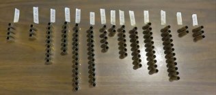

I've run a similar test with my .308 Lapua brass, which wasn't just about the difference in case weight but also the measured case volumes of those cases and the relationship. Since I've found some correlation between case weight and case volume, I was interested just how to use a sorting method that would help with consistencies. I've posted about this on a previous thread. In that thread I mentioned I compared the lightest to the heaviest and found a significant difference between them. What I also did was fire all the brass in 5 shot groupings in their sorted order progressing from the lighter through the heavier. And what I saw was very consistent groups from one to the next. Comparing the lightest to the heaviest did show a significant shift in location for the center of the groups.
