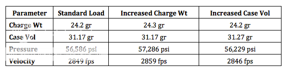

In response to Seymour's original question, I think the best answer lies in the concept of limiting source of error. Which condition would have the greater effect on velocity/pressure: 1) varying charge weight by a tenth of a grain in cases of the exact same internal volume, OR 2) having the exact same charge weight in cases where the internal volume may differ by a tenth up to a few tenths of a grain?
In this example, I think Quickload might give some insight to which factor (case volume versus charge weight) might be the larger source of potential error, at least in as much as you have faith in QL predictions/outputs. I used one of my .223/90 VLD loads as a starting point and 1) adjusted charge weight up by 0.1 gr, or 2) adjusted case volume up by 0.1 gr. Here are the QL predictions/outputs:
As you can see from the Table, increasing charge weight by 0.1 gr had a 3-fold greater effect on predicted velocity/pressure than did changing case volume by 0.1 gr. In this example, I know from testing that the predicted increase in velocity going from 24.2 gr to 24.3 gr is spot on the increase I actually measure with the chronograph. I have not ever loaded cases that differed in volume by ~0.1 gr and tested those to determine how good QL's prediction there actually. However, these predictions at least suggest that as measured in grains, charge weight will have the greater effect on velocity/pressure by a factor of slightly more than 3X.

Taylor, Thank you for this excellent analysis. Many F-TR shooters are weighing powder to the limit of an FX120 scale i.e. 0.02 grains. Using your 3:1 ratio, which matches ones intuition about these matters, to maintain the same precision re: powder capacity, if not OCD, would require 0.06 gr. Your QL outputs are instructive and valid. Ron' s post above, also very nicely done, highlights the probability that there is considerably more than our 0.06 capacity variance out there, some brands being more uniform than others. Just how exactly can a set of brass be matched, and at what time and material cost. being ignored, consider the errant under capacity case, on a hot day, going just off the node. Perhaps there is a brand of case that we gravitate toward which maintains near-identical case capacities and thus shoots well "by accident". any chance it starts with L ?
