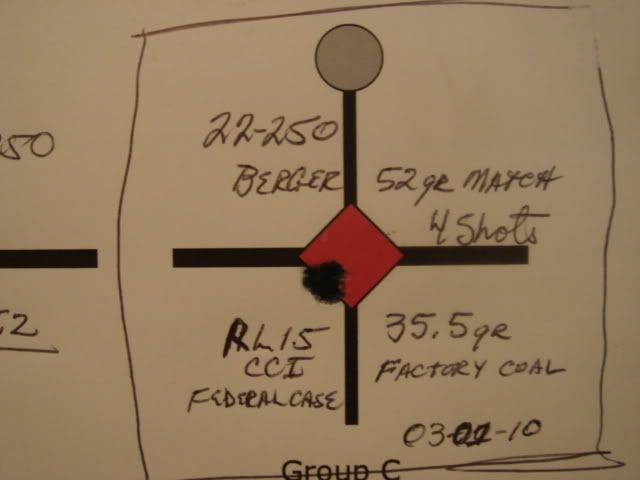

I love 35.5 grns of RL 15 using 52 grain Bergers, CCI 450's.
For what I use the rifle for, this is perfect for me. I can usually put all my shots in one cloverleaf hole.

My first barrel was a 6.5x47L, and I can show a picture just like the above, 5 shots and less than .1 moa.
