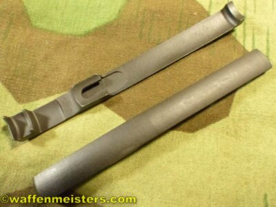

Your extractor has been modified badly; the edge that engages the rim has been chamfered to allow single feeding, but it looks as though it was overdone. The edge of the extractor should not be sharp - that's what is chewing up the rims; that edge should be rounded. It has been shortened so much that it probably isn't fully engaging the rim; the reduced engagement helps that edge chew up the brass. . I'd suggest starting with a new extractor and shaping it properly.
Yes, It looks like the extractor has been damaged from forcing it over the rim. Buy another one on Ebay or Numrich.
Then have someone fit it for you.
Also, The mag box should have a spacer in the rear and a short follower, Without doing that it may never feed right. Is this a commercial Mauser? Another words, What brand is it? Or what country's military made it?
If it's commercial, It may have been set up for short cartridges, But usually they have a spacer in the rear of the mag box from the factory if it was sold that way. Numrich used to sell a kit with a spacer etc, I don't know if they still do or not.
Thank you. I'll look for a new one & feed through the magazine instead. I'm not going to try & shape a new extractor.
