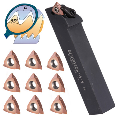

By the way, you do know that is a 55 degree thread, 12 tpi, IMG_2400.jpegnot 60.
I use the Arthur Warner kit Arthur Warner #18
Are there inserts available with the 55°?
Yes,
Here is what I use,
Dave,
The pre-fit barrels sold by Shilen, Shaw etc. were all threaded with 60 degree threads and they will work fine. I don't know if Shilen still does them or not anymore, But if you threaded it 60 degrees, It will work. I just prefer to build them with the proper thread pitch.
