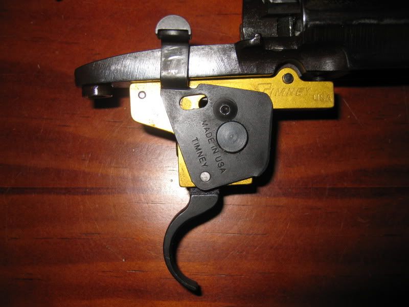

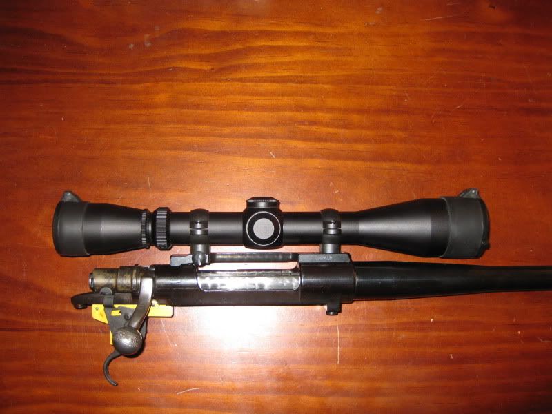

I've got an old '98 Mauser my grandfather built in the 1940's. He had Roy Weatherby turn it into a .257 Weatherby back then. My youngest son and I are rebuilding the rifle, for mule deer hunting, and it's a great project. I think I'm going to end up pillar bedding that rear tang - for all the reasons cited elsewhere in this thread. It seems to have good potential for longish range accuracy, even though it's set up as a hunting rifle rather than a match rifle. Just switched to a Timney trigger & side-mounted safety lever. Nice improvement.
Regards, Guy
