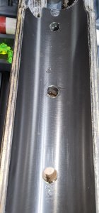

I really liked Devcon 10110 but they got way too proud of it. I started using ProBed and I won’t be going back…I wish it was just slightly thicker, like Devcon, but that’s my only complaint. I don’t really want to get into mixing stuff to thicken it. I use Kiwi shoe polish but considering trying ProBed’s release agent. You get a great looking bedding job:
Yes, it gives the owner confidence. One of my customers explained to me that when it looks perfect he doesn't have doubts when he goes to the line. While looking perfect and being perfect are two different things, its possible to do both. Its part of the mental game.
Then they'll just think they should have glued it...
