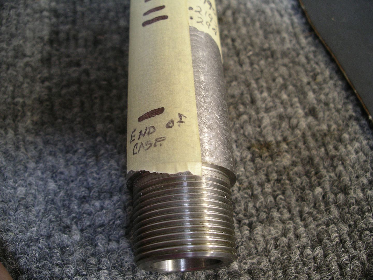

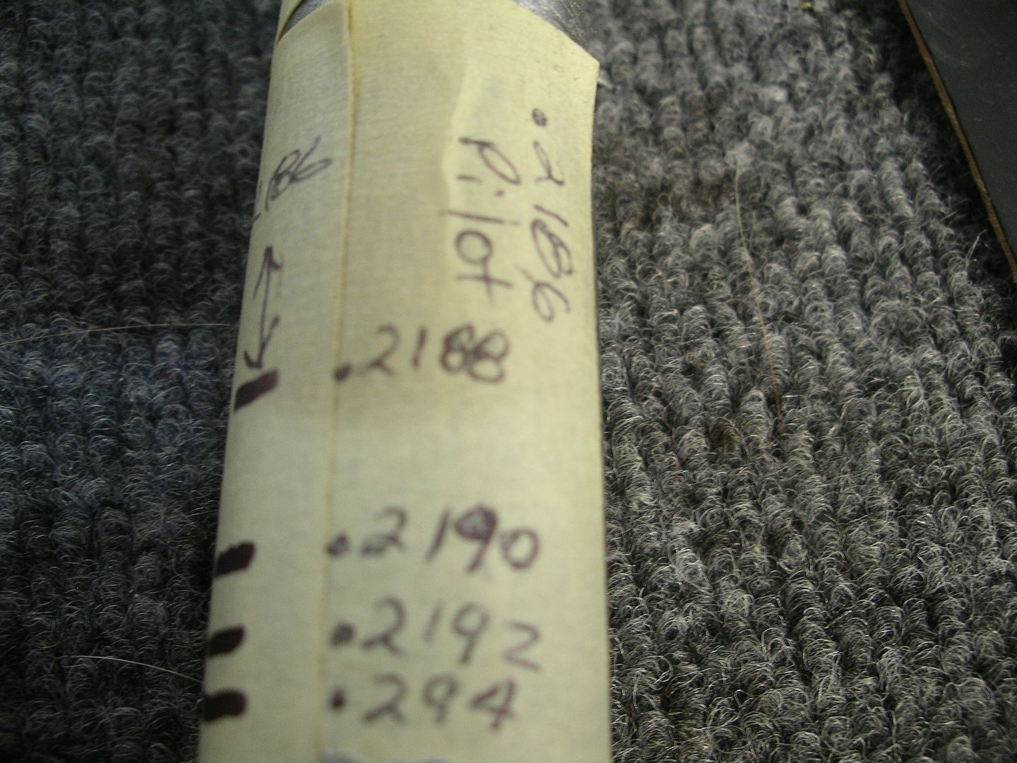

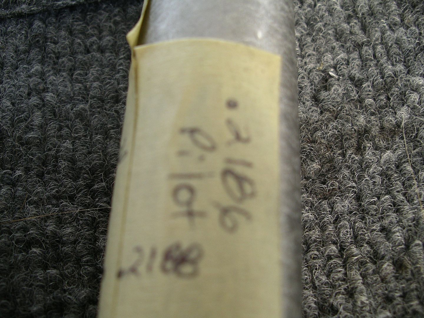

HOw much to cut off is determined by pilots that come in graduated sets, .0001 or .0002. You start off large, and keep going down in size, till the bore becomes uniform.
This shows that the bore dia is .2186 and where the new throat should start, verified by bore scope(bore condition)
Next, using over size bushings, you can determine wear:
Where the end of the chamber will be, thus how much to cut off
This is a 223 AI barrel, Hart 14T, accuracy was restored to 95% new, with groups in the very low 2's. If you do not use this method or one similar, setting a barrel back can be a real waste of money as land height will be shallow. We have been using this method since the late 80's for setting back barrels. There are other considerations on setting back barrels also, like a guy's reputation. I do not do business for others.
