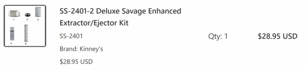

Then the ejector showed me she's weak and NOT doing the job ...
Just ordered a Kinney
SS-2401-2 Deluxe Savage Enhanced Extractor/Ejector Kit

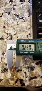

worked on setting up my dies to the chamber lastnite and came to the realization that E Arthur Brown company EABCO has cut their 22 Creedmor barrel chambers too damn tight !
I have had to trim the neck down to .250" after seating the bullet that is the diameter just to
barely get the bolt to close ..
Saami has it at .257" and other prints .255" ....that get's my neck a bit too thin for my
liking and it's a PIA ...my PTG finish reamer should arrive today ..she's gonna get a new profile
hope that helps..
Currently the amount I have to remove is too much of a hair cut !

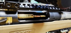

This build is quickly becoming a pain in the azz ....gonna be my last Savage ...
The MDT stock has some lil plastic sliding button that is to contour to the
bolt release armature from the sear at trigger ... Bottom release variation
It engages it and doesn't allow it to return fully forward to reset the trigger
trigger is stuck at rear ...I'll wait till the Elftmann arrives and start to trouble shoot
after that is installed as it changes various parameters ..
Cheap stuff really sucks ....lol ...I'll make it a nice rifle ,,but the amount of actual
fit and finish work is unbelievable today .....nobody seems to give a shit about
tolerances nor quality control ...

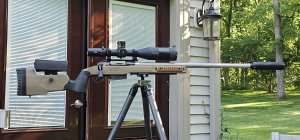

Update !!!
So I gave up on forming brass ..too much work and I'm busy
bought 400 alpha munitions brass...
Called up The Urbanrifleman and gave him a shot ....
Glad I did ...
He churned me out a 26" 1-7 barrel in just a few days it was my doorstep .
So after my sear was lost in the mail I gave up on the elftman trigger and sent
it back ..
Bought a Jard 12oz with the top bolt release lever already part of it ....
happy I did , that savage trigger assembly was a piece of shit ..
Bead blasted the barrel in the cab ...
Machined the receiver today and installed the Jard ..
set the head space on the new beautiful barrel and torqued everything down
after having to replace the front receiver hex screw with an over sized 5/16" x 24
original was weak and stripped out ....arghhh!
it's together ...

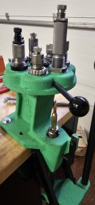

worked up some test rounds
Started with 38 grains of W760 and a 69 GR Hornady Match BTHP
fed 210 M primer

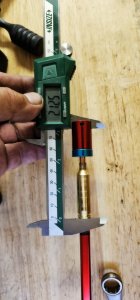

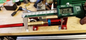

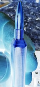

I like to take a brass cartridge that was fired in my chamber , then stick it in the lathe and drill and tap it 5/16" x 43 and use my OAL gauge to establish the OAL...
So I sacrificed an Alpha brass for the ritual...
Took 2 measurements with the Hornady 75 Gr ELD Match ...
this is why you take a couple ..they are never the same...
push it in fully , then lock it down tight and carefully use your Dewey Rod
to push it out of the chamber ....
I'll be seating the 75's at 2.100"

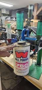

I want to use up this can of W760 I've had since 1995 before it gives up the ghost
I ended up bumping up to 40 Grains of W760
75 Gr ELD M seated at 2.100"
Fed 210 M primer

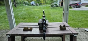

It's more accurate than I am ....after locking down the turrets and zero stop
I thought I'd toss 3 more down range ...
First 2 were almost touching , then of course the anxiety kicked in and I pulled
it ....dohhh! she's a keeper ! looking forward to seeing what these 75's will
do to the chucks and yotes this week....
