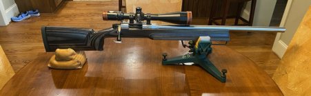

The top one is a KRG Bravo and I bet it’ll just lay in it and bolt up…every Rem clone I’ve messed with has. Pretty affordable chassis too.

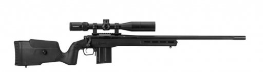

This is the one I really want to go with. I have been looking at Grayboe and they are a true drop in and very nice stocks. However, this build is costly and all I want is something similar to the Magpul Hunter stock. However, I was told the Magpul inlet will not fit a Sendero profile barrel.
Magpul most definitely will take a Sendero/Rem Varmint. I’ll add that’s with room to spare for a longer than typical Sendero shank too. ~2.125” of shank length possible there. I’d also bet with a small notch at the rear of the bedding block the trigger hanger would fit. There’s probably plenty of room for the front of a hanger. The crossbar is a fair amount below the bottom of the action.
^^^ with a 90° bolt release the Magpul will need a small amount of clearance added. Doubtful that there would be any bolt handle issues with the large square opening.
The only hiccup I see with the Bravo from fitting is the front of the trigger hanger. They have a bolt up front for the trigger guard. That might be an issue. The rear of the block is cut very close to the rear action screw so I’d bet a hanger fits there. Everything else would be fine. The show line on that stock is below any bolt release and port plus a large square handle cut. The barrel channel will fit a cylinder barrel so just about anything with a standard OD fits. BAT shown for example.
