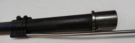

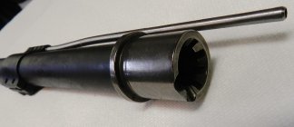

They say a picture tells a thousand words, but in this case I disagree. What are we looking at and how does it work?
The bar is something from the trash heap; Bored a 1 inch hole in it with a set screw to hold the barrel extension. It's just to extend the barrel so I can work on it in the headstock
