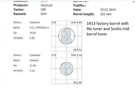

I think I've seen your test center sub-12mm ten shot group with Center X, others too. Is it the one shown below?
Even if it isn't, it's always good fortune find lots of CX that give consistent 12mm or better ten shot groups.

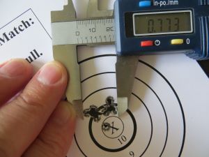

And speaking of factory Anschutz match 54, I have also seen a 1411 do very well with a certain lot of CX, having did a ten shot group at 100 yards that was 19.6mm (0.773") outside-to-outside, which would possibly make it sub-10mm at 50.
Although I've had better results at 100 with other Lapua, such results were not consistently achievable. The lot in question averaged 28.9mm outside-to-outside at 100 over 58 groups. Sometimes ten random rounds from the same box/lot seem to do better than others.

yes, that is the test results I got from my 1413 and it was with my base lot not from anything at the center.
as far as consistent 100 yd/m unless you are shooting in a controlled condition how can you know something down range did not cause any shot to open up the group.
you questioned how I knew the 3 shots not touching the group in this 50-shot group at 100yds. we're not the ammo. well, the other 47 shots were shot when the tails of my flags were near vertical those 3 shots the tails moved before impact, so the results showed how it affected the shot. too many things can happen between 0-100
