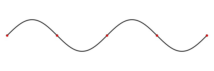

The term "node" comes from the description of a resonating structure.
The way we use the term in load development isn't correct but it can imply a point in time where the object of interest stops for a moment. In the case of firing a rifle, we are interested in having the bullet exit the muzzle at a point in time where the muzzle has reached an extreme position and pauses before it starts to move to a new position.

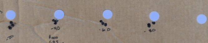

Here is a seating depth test on my hunting rifle.
The big take away for me is that all the impacts are basically the same in reference to aiming point.
I did verify -.040 was the best at distance.
But for a hunting rifle this is very forgiving
