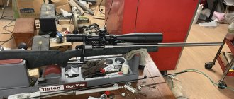

Good point.
Rifle:
Lone Peak Fuzion action
28" CRB Comp barrel
MDT ACC Elite chassis
Triggertech Diamond
Razor Gen 3 6-36x56 MOA
Components:
Alpha Brass
CCI 450 primers
Berger 105 Hybrid
Varget Powder
I anneal after every firing with AMP. Headspace is .0015-.002". Tension is using a PMA mandrel.
