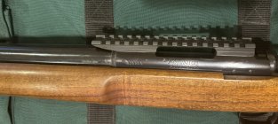

This a .222 Remington magnum, single shot 40-X. I have owned it for years but never used it. I think the .223 put the .222 magnum on the endangered list.
This is certainly not state of the art, and I’m aware of that, but the stock is a beautifully refinished 40-X single shot from a 6 Remington Ackley improved 40-X of a late central Texas gentleman, who was a respected veteran and gunsmith, and I’d like to use it in a match in Travis County.
Then I may transition later on to a true flat bottomed BR stock, and I have a Remington green Custom Shop stock that currently has a .22 LR 40-X in it. But I’m not ruling out that this may perform as well as the barreled action can do. Which is a big question.
I have 400 pieces of virgin brass. Any suggestions guys? I can lay hands on quite a few kinds of .22 bullets, but powder choices and charges for light bullets is rather new ground for me.

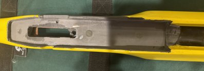

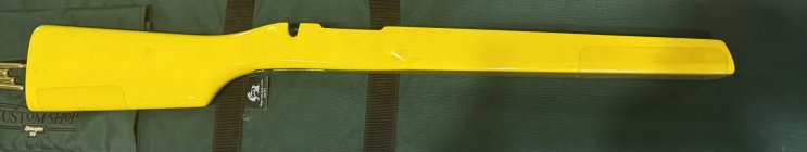

Secondly, this yellow stock, feather weight, was one of Mr. Berger’s. I purchased several of them a few years ago, just as bare stocks. Can anyone tell from the inletting, or perhaps from match memory, what action and barrel contour this would need? I believe he favored a particular one, from appearances. It’s definitely for light gun competition. I’d have to very much surprise myself at BR, before I’d use one of his, but the possibility of it would be a nice form of internal self-motivation.

I believe that the stock is inletted for a glued in Panda, right bolt , right port. An older action might not have an ejector. The cut on the left side is for the bolt stop. If it is old it is probably a Lee Six stock. Lee sold his stock operation to Kelbly's ad taught them how to build them. That particular design was originally made by Lee and then continued by Kelbly's. If your .222 mag has a 14" twist you will want some 50 - 53 grain match bullets. For primers I would use 205s or 205Ms but CCI BR4s would be good too. For a powders to try, some of the best are suffering from availability, but for the straight .222 I shot a lot of 748, If I were exploring today, I would try H335, and I might give N133 a try. For my bench .222 H322 does very well and I am lucky enough to have most of an 8 pounder.
I believe that the stock is inletted for a glued in Panda, right bolt , right port. An older action might not have an ejector. The cut on the left side is for the bolt stop. If it is old it is probably a Lee Six stock. Lee sold his stock operation to Kelbly's ad taught them how to build them. That particular design was originally made by Lee and then continued by Kelbly's. If your .222 mag has a 14" twist you will want some 50 - 53 grain match bullets. For primers I would use 205s or 205Ms but CCI BR4s would be good too. For a powders to try, some of the best are suffering from availability, but for the straight .222 I shot a lot of 748, If I were exploring to day, I would try H335, and I might give N133 a try. For my bench .222 H322 does very well and I am lucky enough to have most of an 8 pounder.
That’s great info. Thank you! I just put the rifle with a fixed power 36x one inch tube scope on the scale and I’m at 13.0. Heavy varmint is 13.5 pounds as I understand it. I’m comfortably in.

The yellow stock is a Lee Six SPG. I had one years ago that only weighed 21 ounces.
From what ai can remember from 25+ years ago, H322 was the favored powder with 52 grn match bullets in the 222 mag.
The 222 mag case found its calling when Benchrest Shooters necked it up to 6mm, the original 6x47. It was quite popular until the 6PPC made it’s debut.
I still have a brand new Lee Six SPG 40X stock, which I bought in 1978.
In the 222 Mag, 4895 with 52's worked very well. My friend and mentor, Art Bourne, liked the cartridge and used it in the early 70's. Different times. 4895, H335, RL7. These were all good powders. Today, it is rare that anyone shoots any of the 222 family for short range BR, but I think it would be fun. WH

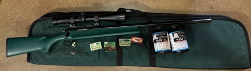

Still the old barreled action, .222 Magnum, but I need to be able is use my front rest and they just aren’t very compatible with beaver tail fore-ends.
“Newer” stock with a flat bottom, that is extremely light. Probably only a 25-30 year old design, with light bullets that are at least that old. These just have to be used before the boxes disintegrate. I don’t even want to know what the BC of these bullets is!
This lighter stock allows an 80x modern March scope. With caps still just under 13.5 pounds. I’ll be zeroing and testing this by early a.m. tomorrow. Richard, miss seeing you on the F-Class circuit!

I think the green stock is a factory (custom shop) 40X which was made to copy the old walnut XBR stock? Lighter, stiffer, less expensive to make and sell. Enjoy your shooting. It is very fun to learn on the old stuff. It is a joy to play with and learn on. I shoot two old Sinclair rifles with Lee Six stocks. Darned enjoyable.
