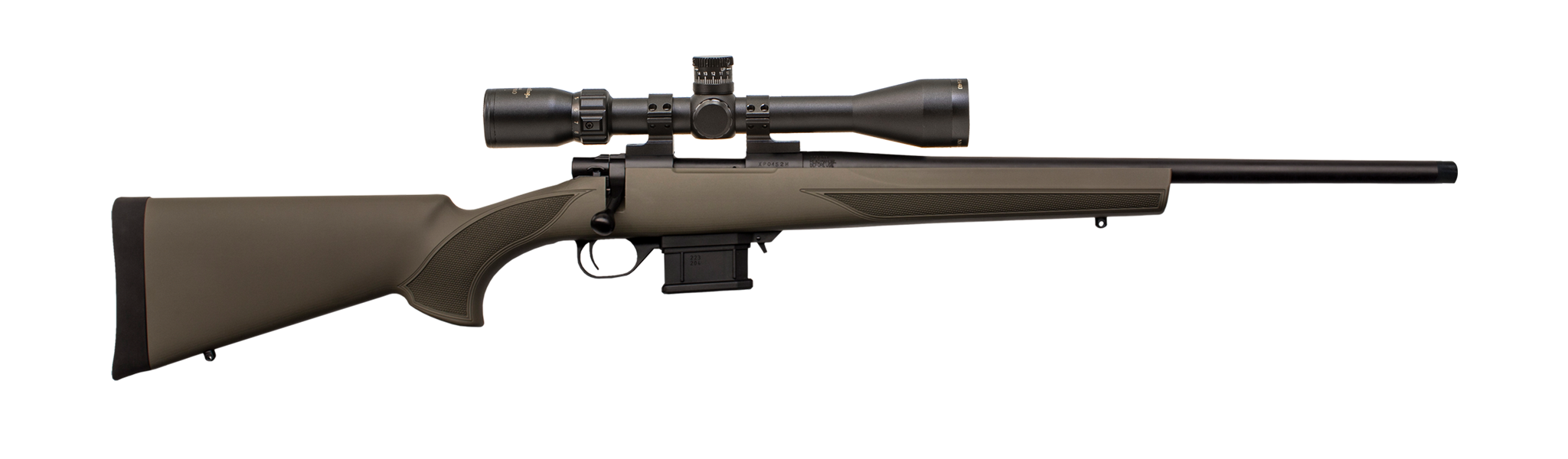

Brothers Howa mini 6ARC
Leverlution powder -105 bullets
Deer Out to 600yds has been taken cleanly ..
105 fits in the mag
105 Berger
Factory Howa mini with green stock
