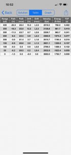

Ruger m77 mkii with a Schilen barrel. My brother and I have shot a ton of deer with that rifle and sierra 85gr BTHP #1530’s. I have never shot any past 200 with them. I have shot steel out to 650 with them.
Muzzle velocity of 3082 FPS and a10 mph crosswind for information.
