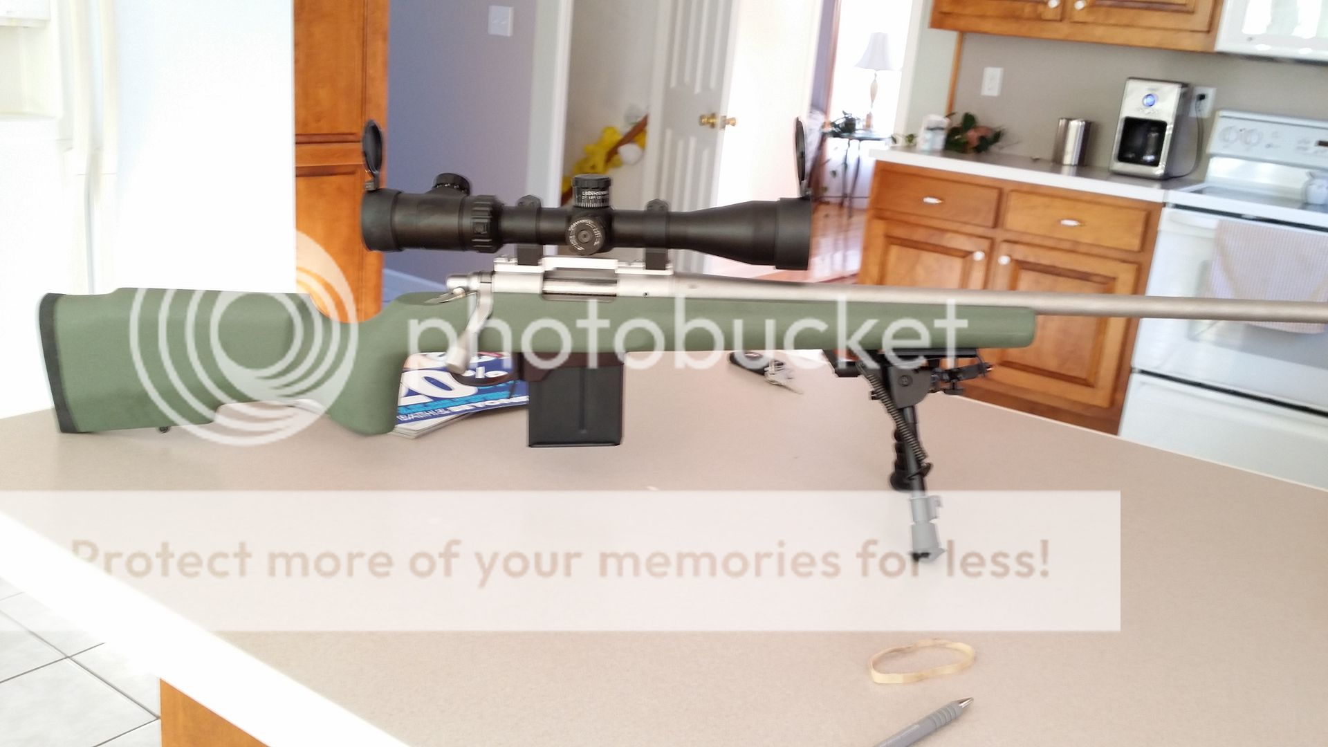

I use an HS precision on my 7-08 hunting rifle, and its almost flush, holds 3. I think the their 223 offering would work for your application. I'm happy with mine. My rifle looks like a hunting rifle and not tacticool.
If you want more than that I'd go with something that will take AICS type mags, something from Badger, Surgeon or PT&G not necessarily in that order.
