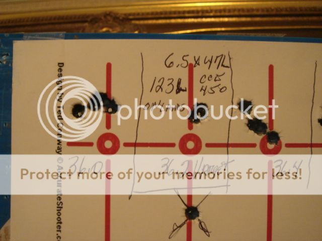

This load works for me and the 123's, I was shooting 4 shot groups that day.
potatoe said:
Dennis, is the only difference in those groups .2 change in charge?
YES, you are correct.
Dennis
PS: Seating depth, sometimes just .2 will also make a difference.
