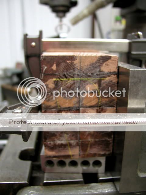

You buy carbon fiber cloth or Kevlar and we Used both vertical and horizontal lamination. We were able to vacuum bag it instead of clamping it as it is the much superior way. Pictured below is the butt of the stock showing the lamination.
On the mill.
On the redwood we put finish on the OD and didn't have any chipout. We bought carbide tipped router bits. We found a cheap source for them.
