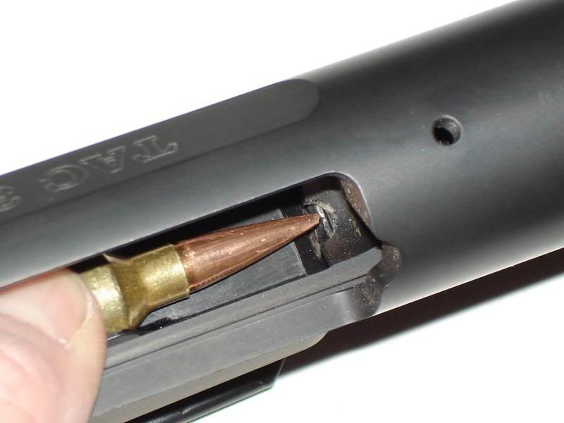

I've had Wyatt's SA 2.995" mag box in both a 7WSM and tried it in the 6.5SAUM, too. Pretty much, the longest you'll be able to feed realistically is 2.975" from that box.

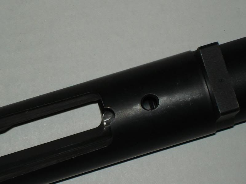

More importantly, at that length, the action's feed ramp becomes the limiting factor. When seated much past 2.950", the bullet tip will actually hit the bottom of the ramp and cluster-F the whole enchilada. That's why Surgeon notches the feed ramp in their 591 SA, like this:
And here's a pic of a modded Stiller, note the feed ramp milled to clear the bullet tip @ long c.o.a.l.
If you've got that covered already, then disregard. If not, I'd re-think that long throat, as the .081FB "GAP 4s" reamer sits a bullet where it does not require modding the action's feed ramp in such fashion. My 6.5SAUM is a R700SA and @ 2.935", a 140JLK clears the ramp & feeds fine. From both a Wyatt's MBE-5/BDL config, and a Surgeon DBM w/ Accurate AICS WSM mags. Additionally, there's another 15-20thou. room to spare, for chasing the lands later in Life...
