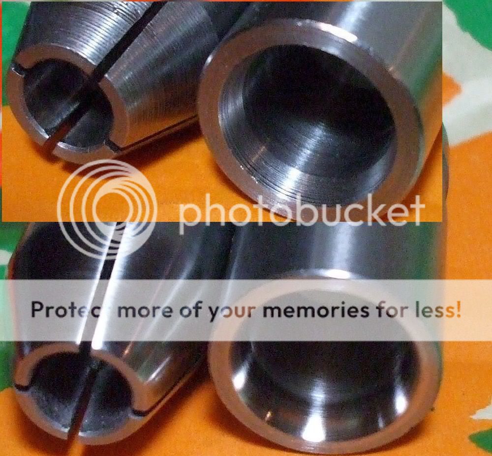

I have never popped the top off the die, or done any damage to the internals. None. But do not operate the die without a case in place or you can collapse the fingers. If you do, just spread them with a phillips screwdriver. I have sized 10's of thousands on Collet dies. I do anneal every 5'th firing, so I don't get into issues with spring back of work hardened brass.
Just for reference I am including a picture (courtesy of Clark on TFL forum) showing how poorly finished the mating surfaces were at some point in time and how they look after polishing. If yours are rough like the top picture, you do need to polish them or they can gall even if lubricated.
[URL=http://s860.photobucket.com/user/jepp2/media/260Leecolletdiecolletandcolletslevebeforeandafterpoishing.jpg.html][/URL]
You have a fantastic Forster press that allows the die to float and self center. That works great with Forster full length benchrest dies with the high mounted floating expander that greatly reduces and even corrects neck runout.
So why use a cheaply made Lee collet die that needs polishing and makes you wonder if you pulled the press handle hard enough.
