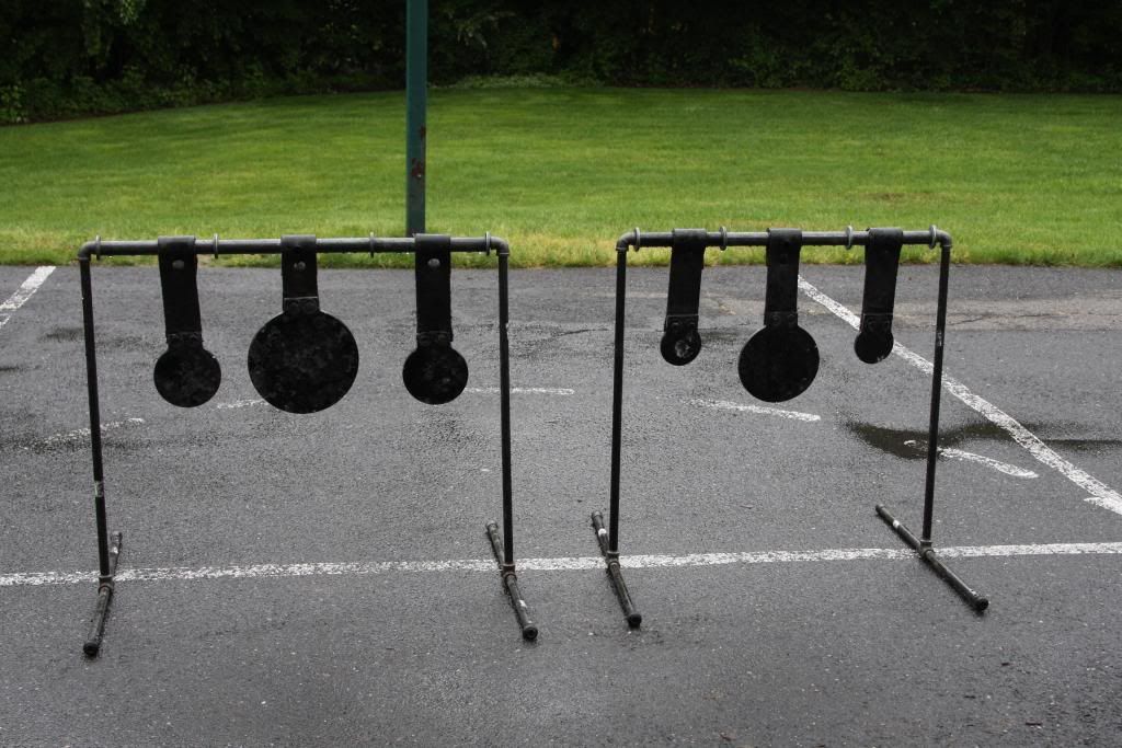

I drive in long spikes, but you could use sandbags on a hard surface. These have been shot numerous times with .338's(Lapua and Edge), .300WSM, .284Win, etc and thousands of .223/556.
BTW, it's just plain old sections of black pipe from Home Depot. If you ever hit a section just screw in a new section. I unscrew the horizontal legs for easy transport. Targets rotate individually on a larger diameter section of black pipe separated by a few washers. I hang the AR500 plated using conveyor belt and hardened bolts.
