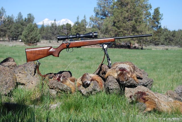

When I want to pop some chucks and want to keep things simple, it's grab my Annie and head out.
Great for a "no reloading" sort of day. :D
