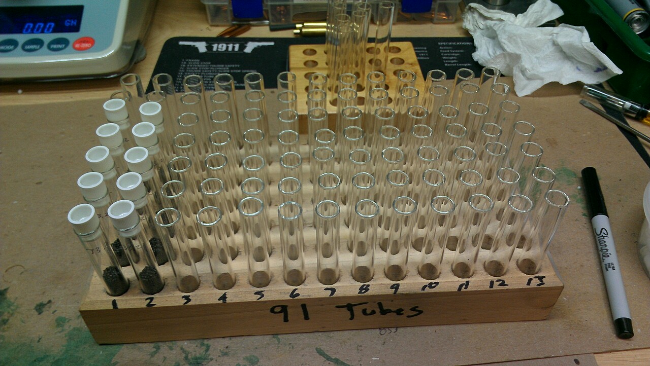

What I started doing is weighing my powder and storing them in test tubes with a cap. Picked up 100 tubes on eBay for like $20. Found an old loading block that fit the tubes. Pre weighing powder when I have time is a real time saver when i need to load for a match or load testing. These tubes fit perfectly in MTM large rifle cases.
++ on pre-weighing powder. I've been doing this for several years now. Fill up several hundred medical glass vials for the .284 and really speeds up the process. Nice winter project. Shot my personal best; one x off the nat'l record @ 1000 with 1 yr. old ammo so that's where I sit on that subject...just got tired of long nights before a match. It basically boils down, just like a lot of this stuff to doing whatever makes you comfortable IMO. Eric in DL
