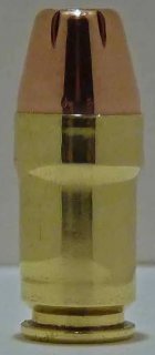

So how important is COL when reloading 40 cal. A comparator can help measure this bullet?
I just want to shoot a safe bullet. I am measuring 5 grains with 180 grain bullet. No issues doing this but I am finding my measurements are not consisten.
I purchased a comparator kit but guys are saying this is not the tool for pistol reloading.
is there a tool that will measure this bullet. I own a good caliper and reads thousands in differences. I just want to be able to shoot this bullet safely. I read as long as they chamber and shoot in the handgun you are good. I just wanted to write my concerns here.

Using Rainier. 180 gr. Hollow point and Bullseye powder
What gun are you loading for? As others have said case length check and OAL rather than using a comparator. SAMMI spec of 1.135 OAL works for most profiles but with some profiles(very few) may be to long. Since the round headspaces off of the case mouth the best way to determine if it is too long is remove the barrel and do what is known as the plunk test.
