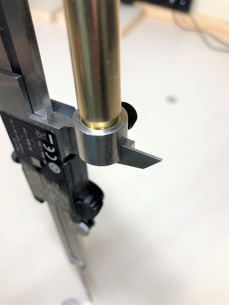

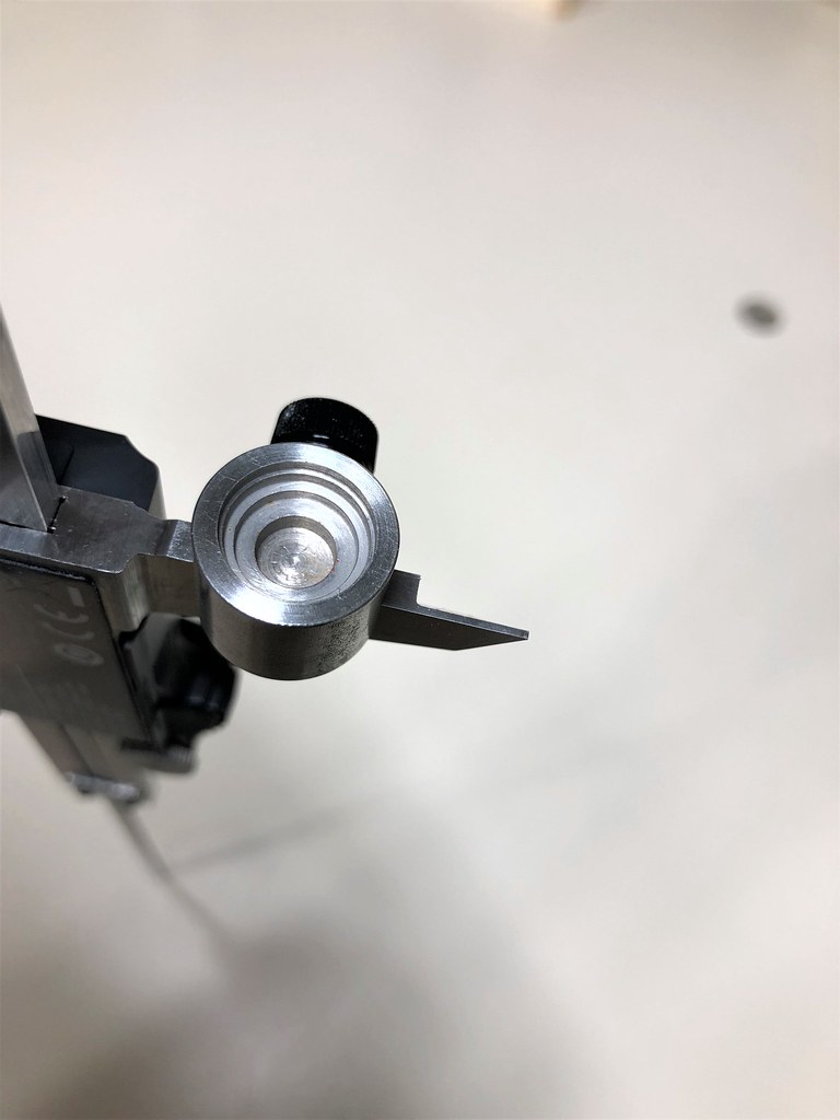

I have both. These are my observations. First, the hole in the Davidson comparator is tapered. .301 a the mouth tapering to .285. The Hornady has a straight .298 hole. This makes the fit more precise in the Davidson. For example, on the Berger 200.20x's when I insert the bullet in the Hornady it does not actually measure to the ogive but further up on the taper so the bullet easily moves around side to side. When the bullet is inserted in the Davidson the connection is solid and there is zero movement. The base that Davidson offers was the game changer for me. It stabilizes the cartridge head and makes getting an accurate measurement much easier. It has steps machined on the inside which makes sorting bullets much simpler as the base of the boat tail has a spot to seat that is square to the comparator. Not necessarily more precise than just using the blade on the calipers but it makes getting a precise measurement easier. The precision and ease of use makes the Davidson worth the money in my opinion.

I like the Hornady but have never used anything else. Lower cost was important to me. Using what they call the anvil base helps instead of just using the jaws of the caliper. Also wiggle the case base around to get it to sit as flat as possible. I assemble all the pieces on the caliper and compress until they align together evenly before tightening the set screws. The measurements you get are fine for comparison purposes once you've established a baseline. The bullet inserts I have are both .010" smaller than the O.D. of the bullets. Also, you cannot directly compare with a the same tools that someone else has. I found the readings I got on a .223 set were a little different than a friends set. That doesn't matter since you should only use these to compare your own components.
