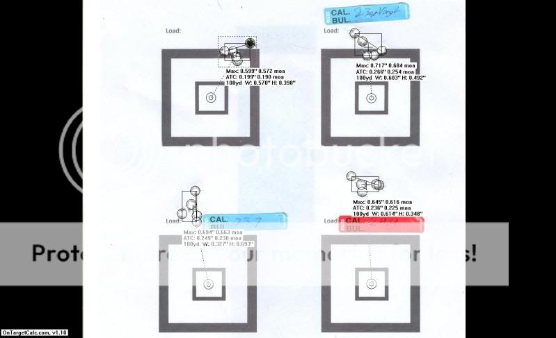

This is a picture of 3 rounds @ 95 yards through my Savage .223 in 12-FV with 9 twist. 55 grain Nosler Ballistic Tip, 25 grains of Varget, COL 2.332,with hornady bullet comparator), velocity is 2950 fps. CCI primers . . .
