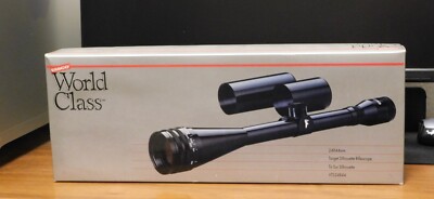

Some may not like these, But A lot of benchresters used these scopes. It's a Tasco Japan fixed power scope, I buy them when I find them cheap. I bought this one last week, It's New old stock made in Japan, Never used. I have used ones too. I also have every Model of the Taiwan made Tasco Target scopes which I have had zero issues with and have excellent glass, It's really hard to believe how clear they are. These old Japanese Tasco's were every bit as good as the Leupolds of the same time.
The super snipers mentioned earlier are also very good scopes, These were also Tasco's before SWFA started having them produced under their brand.
You can find these for 2 to 300.00 usually.
The Taiwan Tasco target scopes have the same design as the Super Sniper scopes but are 1 inch tubes and variable power. It's pretty well accepted that fixed power scopes are more durable and reliable than variable power scopes.
