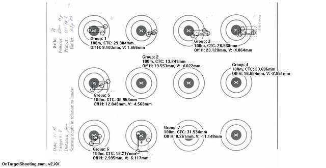

148 gr Hasler Ariete, 44 gr RS 40, CCI BR 2, 109 yards
Group 1:
oal: 2,855, ES:9,84 fps
Group 2:
2,83, ES 26
Group 3:
2,815, ES 22,9
Group 4:
2,795 ES 9,84
Group 5:
2,785 ES 3,28
Group 6:
2,84 ES: 6,56
Group 7:
2,825 ES: 26
It was very windy (up to 14 fps), I tried to shoot under the same conditions, but the target shows wind..
Group 2 looks good, but 5th picture of the first post shows a bigger group and lower ES.
Should I try different primers with that seating depth or play with seating depth around 2,785 (group 5)?
Try a few different seating depths but vary them 0.020" to see a definite difference.
You can vary them 0.005" but I never found enough difference until I varied the depth by 0.020"
Sometimes certain bullets will not bughole no matter what you do. They might in some rifles and not in others.
I ordered a few other bullets. It´s a pity that these 148gr Hasler Arietes seem not work - they are very well made, nearly none differeces in weight or length..
