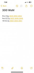

When you are in the node your velocity’s will show. This was the velocity recorded from my WSM yesterday
